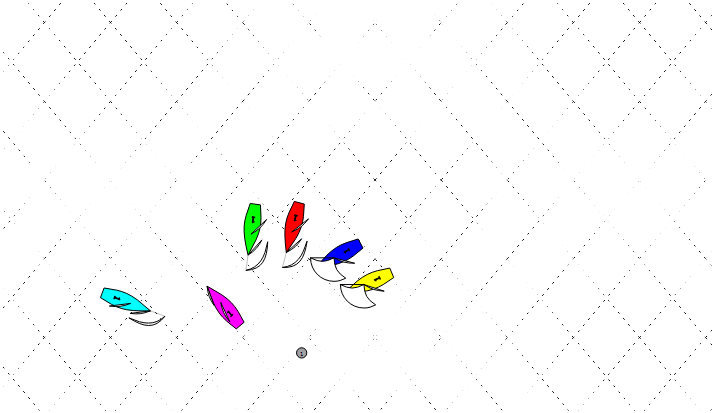

Is this diagram about right?
I’m unclear whether the mark was to be rounded to port or to starboard.
In any case, P is not clear astern of any of the starboard tackers, and none of the starboard tackers are clear astern P, so P is overlapped on all the starboard tackers (Definitions:  Overlap).  When boats reaching on opposite tacks converge, they will almost always have been overlapped for quite some time, no matter how far apart they were initially.
So, regardless of who reaches the zone first, boats are overlapped and rule 18.2(b) applies.  Whichever boat is overlapped outside is required to give mark-room to a boat overlapped inside.
If the mark is to be rounded to port.
P is outside all the starboard tackers and required to give them all mark-room (rule 18.2( b )), and keep clear of them (rule 10), and avoid contact (rule 14).
P did this, although I wonder why she didn’t just run deep and go around the outside of the whole shemozzle.
If the mark is to be rounded to starboard.
P is inside all the starboard tackers and they are required to give P mark-room (rule 18.2( b )).
P’s remaining obligation is, when it becomes clear that boats are not giving mark-room, to avoid contact (rule 14( a ))
In terms of anticipation, particularly with a big pile-up like this, it may become clear from appreciably more than 3 boat lengths away.
The rules contain no requirements for hailing for room (Case 41), except with respect to a close hauled boat hailing for room to tack at an obstruction under rule 20.
A hail, as a situation is developing may be prudent (Case 41) and is an action that a boat may take to avoid contact (Case 107).
No particular words are required, and British Commonwealth sailors will understand ‘Water’ or ‘Room’ according to context.
I don’t think rule 18.2( e ) is going to help anybody.  Rule 18.2( e ), to excuse a boat unable to give mark-room, requires that she be unable to give mark-room from the time the overlap began, which is going to have been quite away back, before boats came close together, so where there was plenty of space to spread out.

The diagram is almost correct. The only significant difference is that P was tight between the Starboard beating boat and the Starboard Soakers and hence could not bail out by Gybing off as would have hit starboard beater.
The mark was being rounded to starboard.
In Hindsight I think I should have been calling for water / room for longer but didn't think it was in compliance with the rules.

Posted By: Brass
Date Posted: 22 Jan 16 at 9:37am
Originally posted by Turkey Pie
As it appears to have been established that I was in the right. If I chose to protest, who would it be against.
1) the 2 asseys that I knew which boats were. These guys had no room to keep clear.
2) the conventional class boats. They were out of my sight, so would need to in investigate who they were after the race
Originally posted by Rupert
Good question! Do you protest them all, or just the first one in the chain? If they are unable to keep clear because of the actions of the boats around them, do they then have to protest the next boat along, and so on?
Leaving Magenta on S out of it, arguably Yellow is not giving mark-room to everyone else, Blue is not giving mark-room to everyone else, etc etc.
It if was decided that Yellow did not fail to give you mark-room to Cyan because they were too far apart (which I wouldn't think was a good decision), then Yellow would have at least failed to give mark-room to Blue, etc etc.
Protest the lot of them.
If you just protested the Assy boat closest to you, then a smart protest committee might then protest each other boat up the chain under rule 60.3( a )(2), but that requires the protest committee to be smart and to exercise a discretion in your favour.
60.3 A protest committee may
(a) protest a boat, but not as a result of information arising from a request for redress or an invalid protest, or from a report from an interested party other than the representative of the boat herself. However, it may protest a boat
(1) if it learns of an incident involving her that may have resulted in injury or serious damage, or
(2) if during the hearing of a valid protest it learns that the boat, although not a party to the hearing, was involved in the incident and may have broken a rule;
Likewise the intervening boats.   They are under no obligation, in any circumstances to protest another boat.
60.1 A boat may
(a) protest another boat,
Don't rely on anybody else to do your work for you.
You have to hail 'protest' and, if you boat was over 6m, display a red flag at the first reasonable opportunity after the incident to get a valid protest in the first place.  Nothing says that you have to hail sail numbers or identify boats at that time. "I didn't think it was me that was being protested" is no excuse.
You can submit a valid written protest within the protest time limit, without including the identity of the boat you are protesting, as long as you do identify the protestee and advise the protest committee before the hearing.
61.2 Protest Contents
A protest shall be in writing and identify
(a) the protestor and protestee;
(b) the incident, including where and when it occurred;
(c) any rule the protestor believes was broken; and
(d) the name of the protestor’s representative.
However, if requirement (b) is met, requirement (a) may be met at
any time before the hearing, and requirements (c) and (d) may be met
before or during the hearing.
Sailing into a pack-up then claiming you didn't have room to give room or mark-room is no excuse:  All the Assy boats have been overlapped for quite a long time (none clear astern of another), and the Sym boats will likewise have been overlapped on Cyan for quite some time and even on the two Stbd Assy boats for a significant time.  The Get out of Gaol  card for 'unable to give mark-room' in rule 18.2( e ) is restricted in application and only applies if a boat is unable from the time the overlap began.
(e) If a boat obtained an inside overlap from clear astern or by tacking to windward of the other boat and, from the time the overlap began, the outside boat has been unable to give markroom, she is not required to give it.
Date Posted: 22 Jan 16 at 9:39am
60.1 A boat may ... protest another boat, but not for an alleged breach of a rule of Part 2 or rule 31 unless she was involved in or saw the incident;
So you may (and indeed under the fundamental rule you really should) protest any and every boat you consider broke a rule.
And
A protest committee may ... protest a boat ... if during the hearing of a valid protest it learns that the boat, although not a party to the hearing, was involved in the incident and may have broken a rule;
So your protest should identify as many as possible of the boats that you consider broke a rule. It seems its now irrelevant who they fouled (if indeed it ever was), and if the PC identifies further boats in the course of the hearing that were involved they may (and really should) be added to the hearing.
Who the ultimate guilty party(ies) are isn't really your problem, that's down to the PC to sort out. They may find some boats in the incident, although they broke a rule, get exonerated because they were prohibited from obeying the rules by another boat's actions, but that's all down to the PC to sort out. The protest form only needs to identify the incident. It doesn't affect the outcome if the protester gets every single rule breach they allege wrong.
Posted By: Turkey Pie
Date Posted: 22 Jan 16 at 6:22pm
Thanks Chaps, Your advice around the rules has been very informative and I'm clear on this now.
I find with the technical jargon of the rules I unfortunately tend to loose my train of thought within one sentence, let alone a paragraph!
