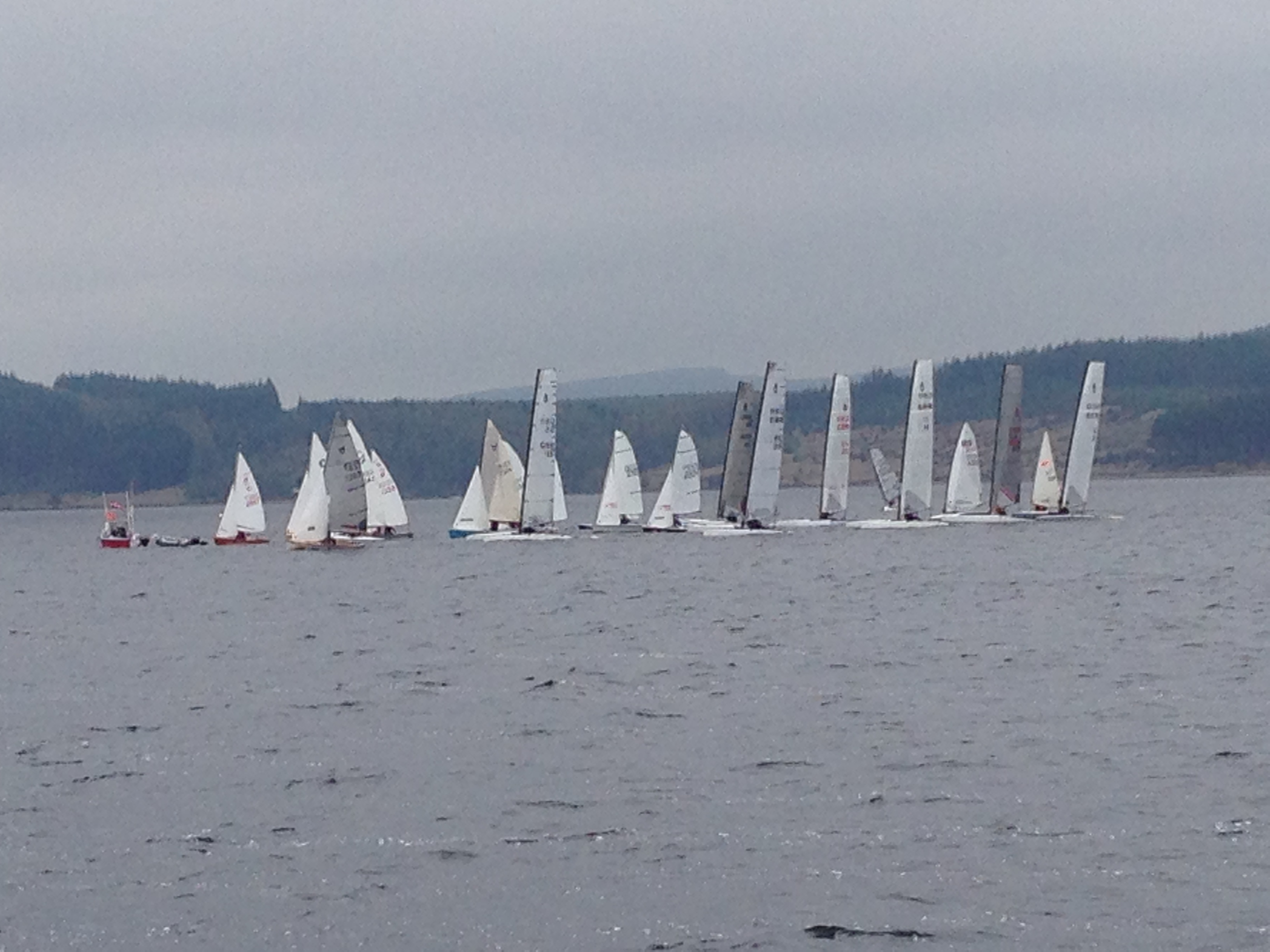

its all about the start really, just trying to get a bit of clear air, to windward of the pack and escapeing the fast boats churned up wind shadow. I take great delight in hammering the start and pushing the miracle around the 1st mark within the first few boats, then just trying to hang one to something near me that has a faster handicap. We often have phantoms, solutions, various asymmetrics and even a couple of cats, for added fun!
the pic below shows the kielder Dam to Dam race - the miracle (us) at the committee boat end of the line finished 3rd overall - having said that most of the cats were on their 2nd cup of tea and had packed their boats up by the time we finished the 10 mile race
