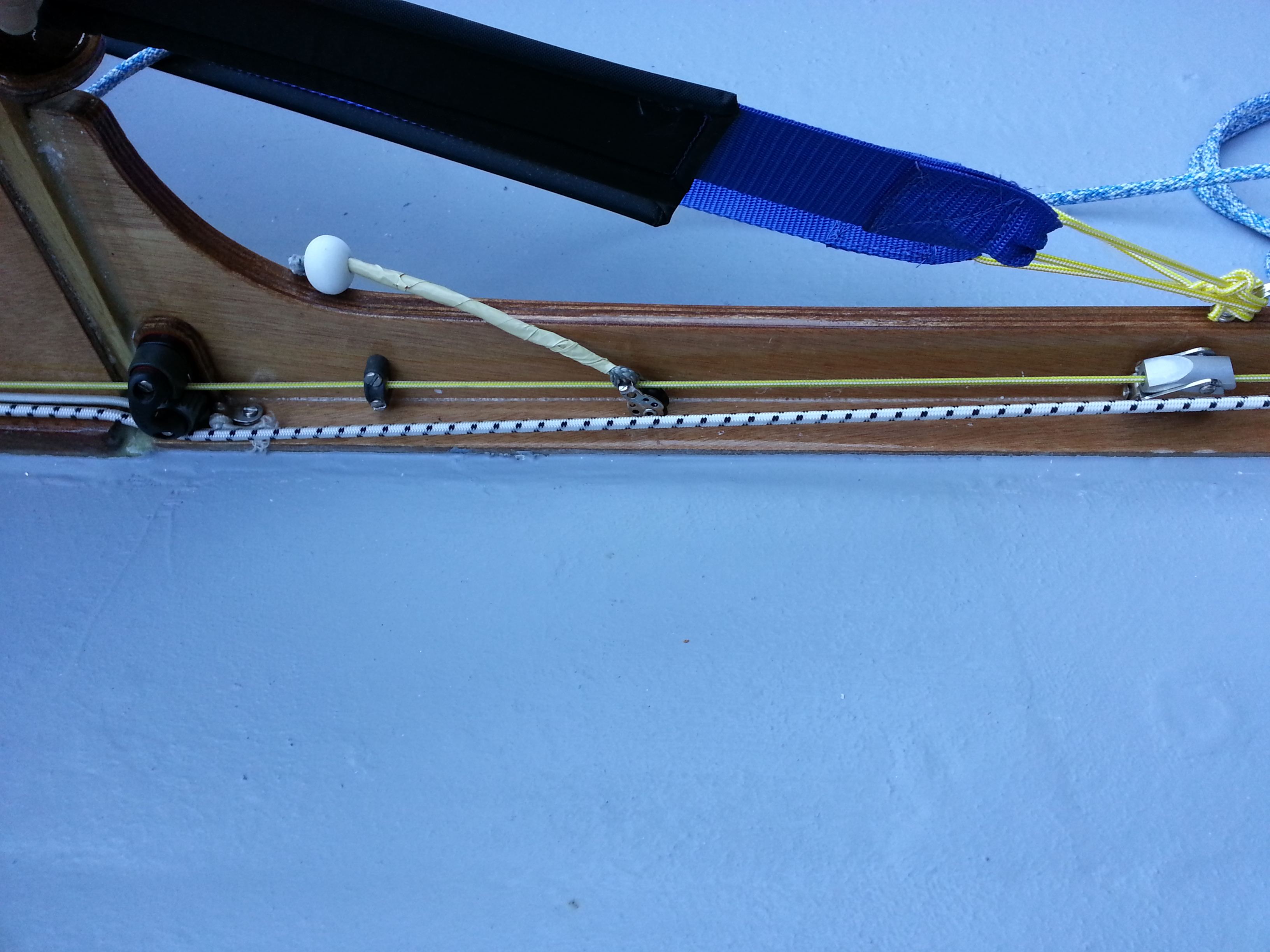

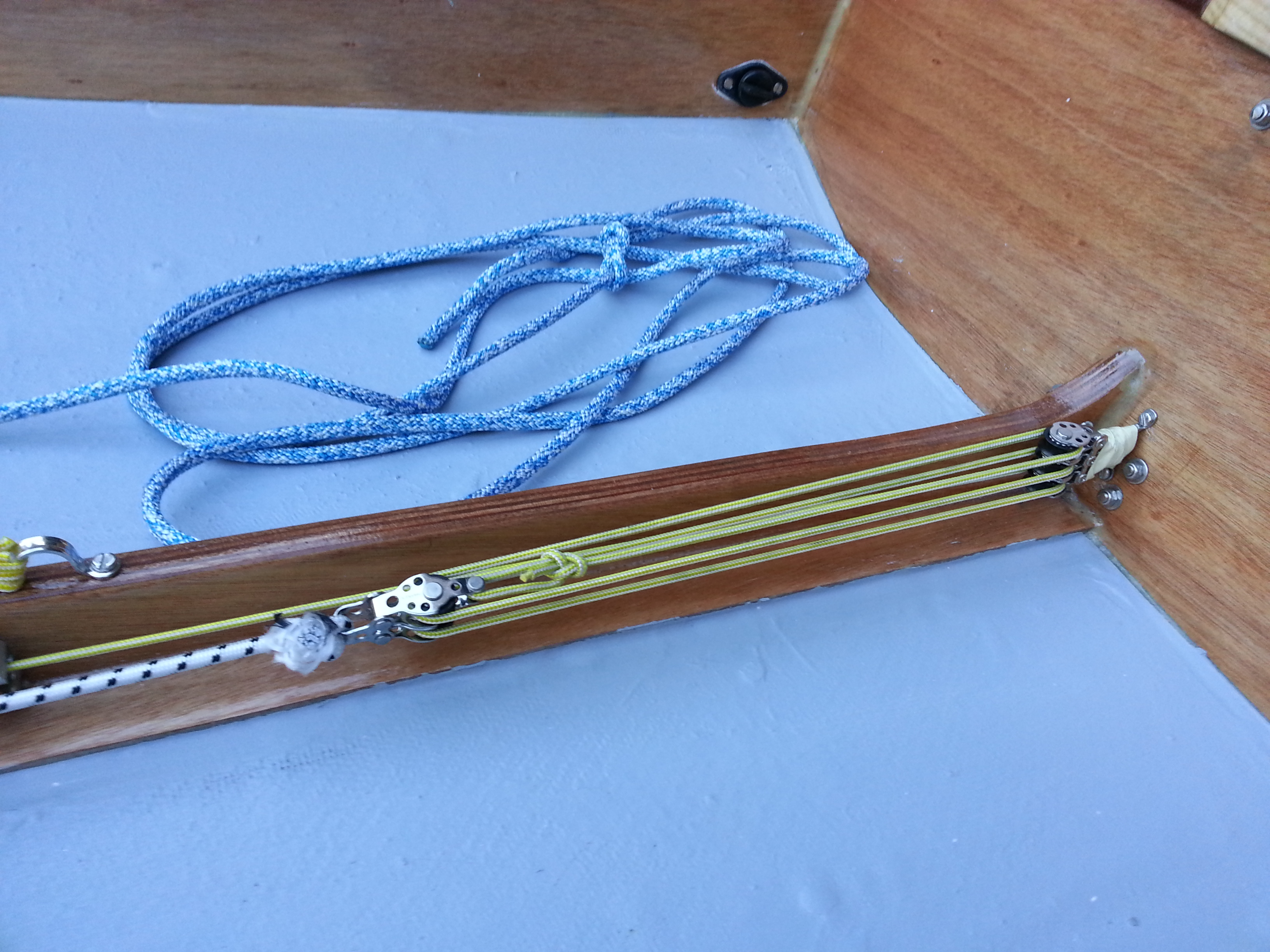

Posted By: Neal_g
Date Posted: 24 Nov 14 at 7:31pm
pictures of pump system
(Redoubt Sc)
Miracle 4040
GP14 13407

Posted By: sawman
Date Posted: 24 Nov 14 at 10:02pm
was just about to post the same pic as neal, the clever bit is the northfix cleat, which holds the halyard, whilst the bungee recoils.
on bagged boats (like my Gibson Miracle) the pump action is much quicker launching, but practice is needed to sync' helm and crew activity, esp if the kite is in the windward bag - which is unlikely on championship courses, but can be an issue on round the can club sailing.
Posted By: NHRC
Date Posted: 24 Nov 14 at 10:39pm
That miracle system is pretty simple. I like it.
Posted By: Neal_g
Date Posted: 24 Nov 14 at 11:08pm
simple is fast
(Redoubt Sc)
Miracle 4040
GP14 13407
