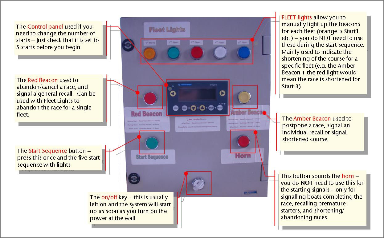

Posted By: alstorer
Date Posted: 21 Aug 14 at 11:35am
For clubs that are doing multiple starts every week, it is definitely worthwhile investing in equipment to make life easier for the once/twice a year ROs. Having a nice large clear countdown timer should be a priority. A large laminated "order of events" poster would be a good idea- including recall procedure. If using flags on cross trees it would be best to have enough halyards so that every flag needed can be attached before commencing the sequence, perhaps with labels to show which flag should be attached where.
An auto-horn could be a good idea- if using 3-2-1-Go it can be simple, just hooting every minute- but remember a manual-hoot function for recalls.
Keep it simple!

Posted By: Brass
Date Posted: 03 Nov 14 at 2:10am
Regardless of whether you go back to 6 minute sequence, AUTOMATE
Get one of these
https://play.google.com/store/apps/details?id=com.paloaltophoto.starttimer
Run it on a cheapo Android tablet.
And/or get the club to splash for one of the various species of Auto-Hoot machines.
It's just dumb having humans watching clocks and pushing horn-switches.

We use a custom combined auto lights box and horn system. Its been running for about 15 years with no failures apart from needing to replace its small configuration screen a few years ago. Press one button at the start of the sequence and it displays the various lights and sounds the horns for up to five starts. It also has lights for signalling OCS and general recall (and shorten course)
I have seen a few other clubs that have combined lights/horns systems, but after sailing at many clubs who used flags or buckets for signalling (which is often daunting for new OODs), I'm sort of surprised that more clubs don't invest in something similar. I don't know how much ours cost - but I'm sure it was less than a grand from a local electronics contractor - £65 a year a bargain.

Posted By: marke
Date Posted: 03 Nov 14 at 3:22pm
Medway
At a start the OOD watches the line and he calls individual recall or GR - they have nothing else to do as the box is doing the sound and visual signals. If recall is called then either the OOD or assistant presses the orange strobe (individual) or red strobe (general recall) and makes a sound signal. If its an individual recall the orange strobe goes off after a minute or when all OCS have returned.
It uses coloured lights - so it can shorten course for individual starts - e.g. green light + flashing orange strobe is shorten course for the handicap fleet.
The sailing instructions allow us to revert to flags if the lights are not working - but I have only seen that happen once in all the time we have used it. We really only use flag C to indicate a change of course.
One day we'll get around to integrating it with our PC based lap timer and results system - but for now the OOD just needs to remember to start the light/sound box at the same time as they click the "timer start" on the PC.
If we were to build another one I would like an aural indication that a signal is coming up.
I have a picture of the control end of the box somewhere I'll see if I can dig it out and post it.
Mark
P.S we use the 6-3-0 system for nearly all of our races. I think you need a 3 minute gap to allow a decent separation and to allow the starting fleet a clear run at the line. Sometimes when doing junior training we have used 1 minute intervals and I just override the automated time signals and signal the lights and horns manually with the external controls.

The front panel of the control box. Its about 600mm high - but would be a lot smaller if made today

Date Posted: 04 Nov 14 at 1:01pm
That looks great. It actually enables you to do easily things that many of our part-time RO's would struggle to do at all, like abandon a race for a single fleet.
The only thing we'd need that I'm not seeing there (but may still be possible), is the option to change between 6-3-go and 5-4-1-go or even 3-2-1-go.
Also nice, on a Wednesday with few boats out, say, if it were possible for someone to set it going then shoot off to join the racing. But now I'm trying to gild the lily...
Where do we send the cheque?

Posted By: marke
Date Posted: 04 Nov 14 at 1:40pm
Well for a wednesday night series everybody could record their own times when they sign off. Better still - we have a PC based signon system - so you could have a reverse le mans finish. As soon as you finish, you sail to the shore, chuck your crew out, who then runs to sign off - your finishing time is the time you signed off!
[Or how about huge QR codes on the sails with a high resolution videocam]
Actually there was one infamous occasion of a junior race where somebody started the race (i.e. pressed the green button) and I used a copy of our race timing software from home, getting the finish times using the club webcam. Worked fine except when someone logged in and tried to command the webcam to look somewhere else!
[Medway - sorry this is one of a kind - but I'm sure any reasonable electronics contractor could knock one up (and include the option to set the start intervals - which ours doesn't have). The horn button just sends a current to a (loud) air horn). The lights are coloured - about 6" diameter and fairly standard items - and surprisingly they last for ages. We have two lights for each colour set at a shallow angle to one another, to give a wider field of view (and also to provide some redundancy).
