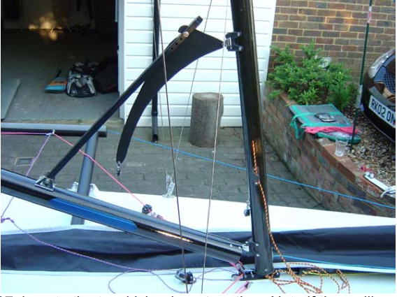

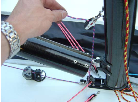

Tell me kind folk is there such a thing as a jamming cleat that works in both directions?
I've finally sorted my wing wang and it features a continuous rope which at the moment is cleated on both sides, it would be less time consuming if it could be cleated centrally if such a device existed.

Posted By: iGRF
Date Posted: 03 Jun 14 at 12:33pm
In order to function you have to uncleat the downwind side then pull on the upwind side and cleat it off. You (I) then forget to cleat the downwind side, later on you gybe, pole collapses to leeward and is very difficult to haul back underway.
One do it all cleat would solve all that. Uncleat pull one way then cleat, next tack uncleat pull the other way.

Posted By: iGRF
Date Posted: 03 Jun 14 at 2:46pm
It could be done, and I have the germ of an idea, but need to check exactly how the Alto is currently set up to see if it can easily be adapted.  I'll have a look next time I'm at the club.
Erm, mine might not be like those Alto's at your club, I've moved things around that often I can't even remember where the wing wang control was, I think it was set up so the crew did it but I like to make the call wether to wing or wang, so the controls are now back at the helm. Hence why I want a single pull option one way or the other, no having to reach over and uncleat the downwind side.

So long as you haven't changed the initial tackle arrangement directly acting on the pole my check at the club should not be in vain. I envisage you ending up with one line for port winging, one for starboard wanging and one (new) one for centering, which is what you want, right?
Posted By: iGRF
Date Posted: 03 Jun 14 at 5:57pm
I need to get you pics of what I have which is a continuous rope linking both sides of the wingwang and acting on separate blocks on either side, currently also cleated on either side.

So this is the current set up, the continuous blue rope with the two swivel jammers.
Posted By: AlexM
Date Posted: 05 Jun 14 at 7:55pm
Strange they're not in the same position either side..
Move the port swivel jammer to the same position as the starboard one and then put a center one in it's place which tensions both lines together.
Posted By: iGRF
Date Posted: 05 Jun 14 at 8:16pm
I'm trying to do away with one, not add another.
They're where they are because there were already holes there, not being OCD, I don't need things to be symmetrical, in fact if they were symmetrical I'd move one jet to piss off OCD people on the verge of the autistic spectrum, that crew for me and don't enjoy the delights of chaos theory.

If you want to wing it to port, wang it to starboard and centre it then you will need three cleats. I’d have preferred simple cleats with pivotally-mounted (or just tied on) blocks behind them, though: simply grab the line and pull to wing, wang or centre.
Posted By: iGRF
Date Posted: 06 Jun 14 at 9:43am
Well in order for it to move obviously everything has to be uncleated, it then moves, then you cleat the upwind side, because as you know even the time spent doing this could cost you a place or your head isn't where it should be out of the boat looking for whatever opportunity is about to present itself.
Then in a perfect world, you uncleat, let the wind do it's work and drop the pole to the leeward side before the gybe and you're tee'd up with the wing already fully wanged. But I'm sure you're also aware of the chaos that can be ensuing in the heat of it mark rounding if it's a bit crowded.
So a one cleat system would be such a bonus with one less thing to worry about, the cleat is either on or off and you don't have to worry about the other cleat being prepped.
