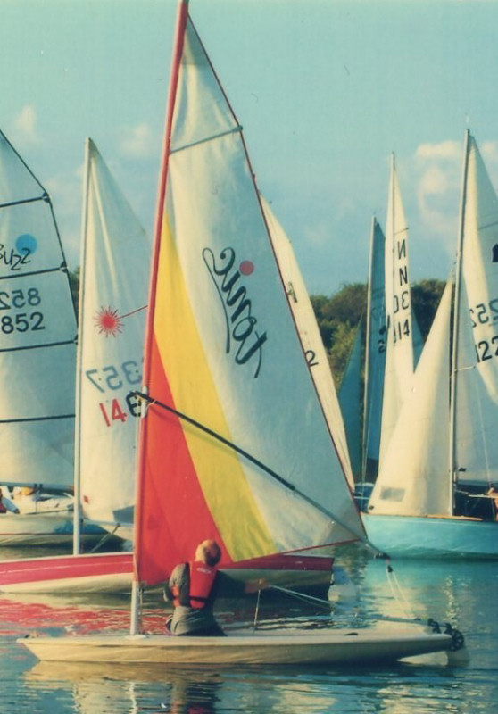

Date Posted: 04 Feb 14 at 9:51am
Dinghies tried the wishbone boom on several boats, partly to get rid of the kicker, partly because they were trying to jump on the windsurfing band wagon.
Up to a point, it worked, but with only outhaul (by raising and lowering the boom on the mast), very simple cunningham and aft mainsheet to control things, it was pretty much impossible to fine tune the sail to the weather once the breeze was up. Given the amount of time I spend fiddling with kicker tension in boats with unstayed masts, it isn't surprising that the wishbone rig was really only good as a play boat, not for serious racing.

Date Posted: 04 Feb 14 at 11:59am
I'm not sure the 80's soft windsurfer style rig on the Tonic was what I'd call sophisticated. I did put a decent windsurfer sail and mast on at one point, but the clew height was far too far up to attach the mainsheet to, really, and I wasn't in a position to get a sail specially made. The other problem was the downhaul pressure needed, too - the hull couldn't have taken it. Was fun experimenting, though.
