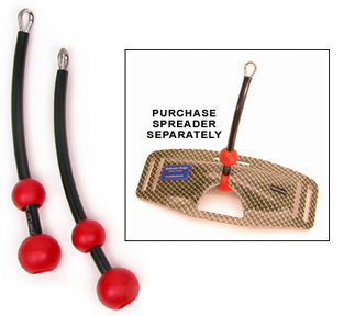

Posted By: Jack Sparrow
Date Posted: 06 Jun 13 at 11:24am
I'm saying that QR devices should be the rule not the exception and something should have been designed by now to facilitate an exit without having to resort to total loss, it's not rocket science and as with helmets about every other sport recognises the likelihood of head trauma, it's another example of the damned activity and the people in it being stuck in the dark ages - is what I'm saying.
Here you go... it's been around for quite a few years... but you wont like who designed it....

Posted By: iGRF
Date Posted: 06 Jun 13 at 11:44am
Yeah saw that, it doesn't address the issue, which is to release under load.
