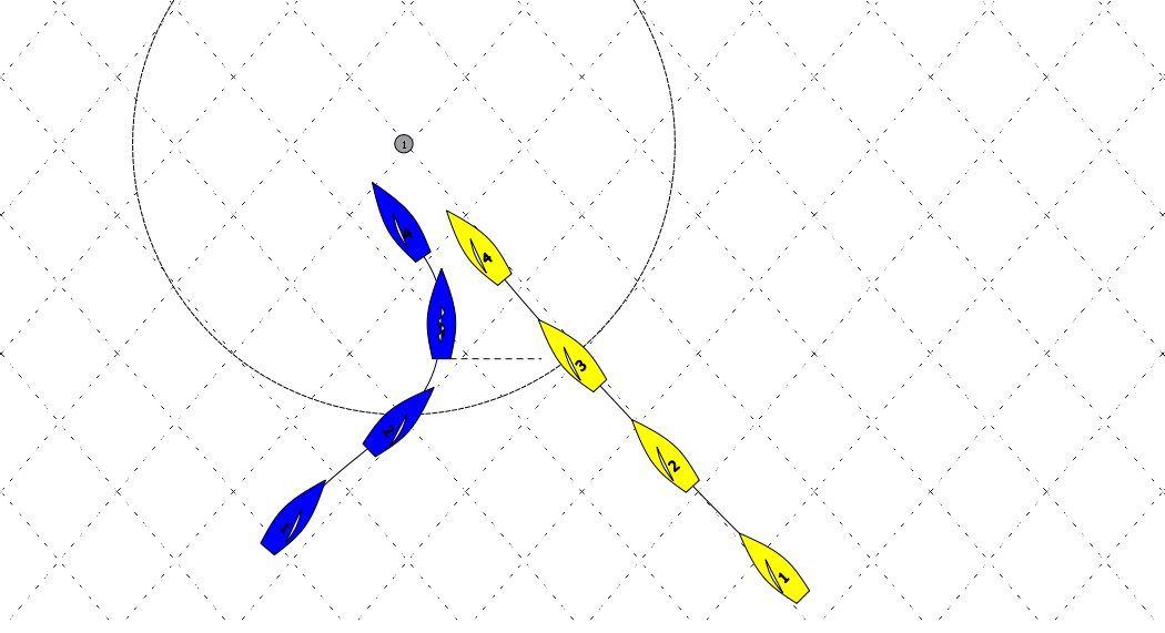

From your description this is what I'm imagining, the important point is if the overlap exists when blue reaches head to wind or not.

The important point is if the overlap exists when Blue changes tack (ie. blue passes head to wind) if the overlap doesn't exist at that point the yellow has no room. However rereading the description it sounds like the overlap would have existed as blue passed head to wind.
Posted By: Quagers
Date Posted: 15 May 13 at 5:46pm
Ok new picture, is this what happened?
Again the important point is the overlap when blue passes head to wind, even if thats subsequently broken again blue must thereafter give yellow mark room.
If there is no overlap at that point yellow gets no room and must avoid.

Posted By: Quagers
Date Posted: 15 May 13 at 11:14pm
It's quite possible though that even though the boat ended up to leeward clear ahead, an overlap did exist when port passed head to wind and was subsequently broken as the bore off.
Its not something OP would necessary notice because its not something people look for but is what this protest would hinge on in the room.

Posted By: Brass
Date Posted: 16 May 13 at 12:03am
OK, so that's pretty much your second diagram.
In that case, B, in addition to being required to keep clear under rule 13, owes A mark-room under rule 18.2( a ) from the time she passes head to wind and becomes same tack overlapped on A, until her transom line swings clear ahead of A, at which point, if she has not yet reached her close hauled course, she remains obliged to keep clear of A (rule 13), but ceases to be obliged to give mark-room.  Once she reaches her close hauled course clear ahead of A, she becomes the right of way boat (rule 12) with no mark-room obligation.
Then, when A becomes overlapped to windward inside, A once again gets rule 18.2( a ) entitlement to mark-room.
I don't think it's a crucial issue at all.
As far as I can see, there is no question that from the time B passes head to wind until she reaches her close hauled course clear ahead of A, B is keeping clear and giving mark-room.

Are we talking about the OP scenario diagrammed by Quagers thus:
Here, no boat tacks onto port.
Rule 18 begins to apply when Blue passes head to wind and both boats come to be on the same (starboard) tack.

By 'first boat' I take it you mean Yellow.
There is very little Yellow can do to influence whether she becomes overlapped or not.
Yellow's tactical objective is to gain an inside overlap on Blue so that she is entitled to mark-room.
Blue's tactical objective is reach her close hauled course, and remain clear ahead and equal gauge on Yellow, so that she will be free to tack around the mark.
It depends on Blue's judgement and boat handling whether Blue can achieve that or not.
Originally posted by RS400atC
So once the second boatBlue is to leeward on portstarboard<?>, the first boatYellow has only the right to room to keep clear and can be sailed the wrong side of the mark?
NO, once both boats are on the same tack in the zone, whichever boat is overlapped inside is entitled to mark-room.
If Yellow is clear astern, she is give way boat (rule 12), as you say, entitled to room to keep clear (rule 16.1), but in that case, all she does is trails Blue around the mark.
If Yellow can get her inside overlap, she would become the windward boat, required to keep clear (rule 11), but Blue cannot sail her the wrong side of the mark, because by becoming overlapped, Yellow gains her entitlements to mark-room (rule 18.2( a )).
In the diagram @4, Blue is forcing Yellow the wrong side of the mark, and is breaking rule 18.2( a ) by not giving mark-room.

No, Knotty The boats still need to tack to round the mark so neither of them is fetching it. So 18.3 does not apply.< id="adlesse_unifier_magic_element_id" style="display:none;">

Agree that in that case, she could be absolutely 'unable to give mark-room'.
Why should P have any protection? In the zone rule 18 is the predominant rule, and rule 18 is clear that P never had any rights of any description. !
I'm also a bit uncomfortable with the language of protection being applied within rule 18, but that's exactly what rule 18.2( e ) provides
Seems to me that as rule 18 is evolving over 4 year cycles on the whole its getting more and more hostile to complex manouvers within the zone.
Although I just glanced at the 93 rules for comparison*, and back then they were explicit that if you tacked in the zone you had to give room to a boat that had to luff past your stern and thus gained an inside overlap, (42.3(a)ii) so there's been no major game change over the years in this particular aspect.
*I'm very bad at throwing away old books!
I think rule 18.3 has been pretty stable since the 1995 rewrite, but its predecessor certainly moved around quite a bit in the 93, 89, 85, and 81 rules.
Thanks for pointing out the 93 rule, the language of which matches up with the current MR amendment to rule 18.3, which I had always found a bit baffling.
I'm quite happy to have it 'hostile to complex manouvers within the zone'.  In my experience that's when competitors lose track of rights and entitlements and start piling into one another.
1993-97 rules is the one book I don't have, otherwise, mine go continuously back to the big American/European fusion in 1961, plus the American rules of 1953 and the RYA rules of 1947.

However, for your "turnstile": the room required under rule 15 would almost certainly be far greater
Gordon
Posted By: sargesail
Date Posted: 27 May 13 at 4:15pm
Don't disagree with that either Gordon.  Although it is my assumption that by tacking clear ahead and to leeward P has fulfilled her obligation under 10, 13 and 15.
But I want to draw out the distinction between an 18.3 situation where the tacking boat "shall give mark room if the other boat becomes overlapped inside her" and where therefore she has to anticipate the requirement, and this situation, where she does not have to anticipate that the other boat will choose to go inside.
This seems to me a logical application of the principle behind 19.2 (c).
Remembering too that S does have choices.  She can keep clear by slowing or going to leeward too.

I do not think you can assume that just because a tack is completed clear ahead and to leeward that P has fulfilled her rule 15 obligation. How far ahead? How far to leeward? If S is obliged to make an unseamanlike manoeuvre in order to keep clear then P has not initially given room to keep clear. Room to keep clear includes room not to touch the mark.
There is a debate amongst match race umpires. Many believe that if there is no contact then rule 15 cannot have been broken. I would argue that this is not the case and that rule 15 can be broken without there being contact.
Gordon
Date Posted: 27 May 13 at 7:50pm
Sargesail, it doesn't seem desirable to me that a boat that chooses to undertake the very high risk activity of tacking in the zone in front of a ROW boat should have any confidence that they have any rights.
For ordinary club sailors like me I think it's probably best considered like taking water you aren't entitled to if a gap opens up - if you get away with it fine, but if you don't you just have to put your hand up and take your penalty. After all there can be few situations where one *must* tack in the zone,in most cases its going to be a tactical decision, so its not unreasonable. Match and team races OTOH are places I will not go...
Its a hopelessly pointless - indeed dangerous - exercise to try and double think what one thinks the rules ought to be trying to say, but while I agree in the rules there's a general tendency that a boat holding a steady course does not have to anticipate what another boat will do, this isn't the situation here. It would not seem out of line with the general thread of things that a boat that elects to tack in the zone should be required to anticipate that a boat approaching the mark on a steady course to round the mark will continue to sail that course and round the mark, especially as the rules clearly state that in the situation where a boat was not clear ahead when she entered the zone then she may at any time have to give water.
To me, as a definite rules amateur, I think that's the important point: the rules say you must give mark room if you were not clear ahead, rather than you need only give mark room if the other boat is overlapped*. So before they tack P already knows that they must give mark room to any boat that gains an overlap, no matter when, and surely they must judge their tack accordingly and its not unreasonable to expect them to anticipate the results of their manouver.
Conversely S knows that if they gain an overlap at any stage of the proceedings they are entitled to mark room, and shouldn't be require to anticipate the possibility that P may get themselves in a situation where they are unable to give it. Your interpretation of rule 10/13/15/18 seems to me to make for an awful lot of switching off and on of ROW in fractions of a second, and its very hard for this rules amateur to believe that's desirable or even the correct interpretation.
Gordon,
Thanks for acknowledging that there is debate around the rule 15 issue in your second para.  I have been involved in such discussions with umpires, and found the split interesting....
In the first instance I am trying to resolve this rule situation....I am not looking at the OP's situation specifically, but using the assumption that P fulfills her Rule 15 interpretation as part of my hypothesis.  So the answer to how far to leeward and how far ahead is far enough.
That said I do want to understand "why room to keep clear includes room not to touch the mark"?  I take it that you do not accept my assertion that this is akin to Rule 19 - if the room isn't there then it can't be taken?  If S sticks his nose in to a non-gap then surely tough luck.....?
But I go back to my starting point - P is mad to tack there......I'm just trying to get to the heart of the rules....can't see it in the Appeals Cases or the TR Call book but I may be missing something.
Matt

When P reaches a close hauled course she acquires ROW. She must initially give S room to keep clear. Room, under the nex definition includes space to comply with her obligations under rule 31 i.e. not touch the mark.
As to the debate amongst umpires I believe that the "I gave room beacause the other boat didn't hit me" is somewhat of a cop-out, making life much easier for umpires. The most difficult moment to judge is when a boat establishes an overlap from clear astern inches/centimetres to leeward of the other boat. If the now keep clear boat cannot chnage course to keep clear without immediately making contact then I believe that she has not been given room.

Which is interesting because it is in conflict with Rule 18.2(e).
Posted By: gordon
Date Posted: 27 May 13 at 9:33pm
I am not convinced that there is a contradiction.
If P finishes her tack clear ahead but close enough so that there is a rule 15 issue then P and S were almost certainly overlapped as, or soon after, P passed head to wind. If either P or S were in the zone at this time then 18.2a applies and in addition to meeting her rule 13 and then later rule 15 obligations P must give mark room.  18.2e does not apply because the overlap was not obtained  from clear astern or by S tacking to windward. S, overlapped on the inside to windward, is entitled to room to tack.
If P breaks the overlap, 18.2a ceases to apply only to reapply when S establishes a new overlap. If P is now unable to give mark room it seems improbable, to say the least, that P was giving mark room whilst tacking.
Gordon
Date Posted: 27 May 13 at 10:38pm
I am P approaching....I know that at a windward mark unless one of us is fetching the mark then I can consider Rules 10 and 13 as if the mark is not there.
Maybe what this thread is highlighting is that that rule of thumb we've always worked by isn't entirely enshrined in the rules and in fact there's an exception...
I sail boats that go very fast upwind, are wide, but come very slowly out of a tack, and I can easily envisage this situation happening.
But I think on the whole I'm with Gordon. Rule 15 is critical. With the revised definition of room that includes compliance with rule 31 then I really cannot imagine a situation in which P can be considered to have given room if S doesn't get round the mark without touching it.
Certainly in the boats I sail neither bearing away behind a slower boat or attempting an immediate slow down could remotely be considered manouvering in a seamanlike way.

If P reaches her close hauled course clear ahead, whether above or below S's course, I think this is looking like a 'pure' rule 15:  if there is time and space for S to keep clear to windward, there will proabably also be room for her to bear away and go to leeward (as you say, starting sails and slowing up as necessary):  special circumstances such as a third boat to leeward, of course, excepted.
Agree with Gordon, that if the boats are really close together, there's every good chance that P has not given S room to keep clear, but it might be that the boundary between rule 13 and 15 is indistinguishable, whether on protest hearing evidence or umpire observation.
I also teased out the other scenarios as below.
If P reaches close hauled overlapped outside S, rule 18.2( e ) will not apply because S does not become overlapped from clear astern, but supposing that at the instant she reaches close hauled she is unable to give mark-room, will she not also be unable to give S room to avoid the mark so as to comply with rule 31, and so will not initially be giving S room to keep clear in accordance with rule 15?
If P becomes overlapped inside S before reaching her close hauled course, P is entitled to mark-room, but is NOT entitled to room to bear away to her close hauled course:  S can give her room to sail a pinched, luffing course to the mark, but still need to take action to avoid her, before she has reached a close hauled course, thus P will almost inevitably break rule 13.
If P has room to reach her close hauled course overlapped inside S, then P, overlapped inside has mark-room and S gets nothing.
I'm just very mindful that this is all happening inside the zone, probably within two boatlengths of the mark, with boats close together:  If P intentionally played for one of the above situations, it's going to require very precise judgement and boat handling:  one slip-up and it all turns to custard.
Posted By: Brass
Date Posted: 28 May 13 at 12:01am
I thought we'd all agreed that while it would seem logical to extend the 'if she is unable to give mark-room' get-out in rule 18.2( e ) to mark-room under rule 18.3( b ) the rules don't say that:  When rule 18.3 applies rule 18.2 does not apply, so there is no get out of gaol card under rule 18.3.
Just another thing while thinking about rule 18.2( e ) and rule 19.2( c ).  The get out of gaol criteria are subtly but distinctly different:
Rule 18.3( e ) 'from the time the overlap began the outside boat has been unable to give mark-room'
Rule 19.2( c ) 'at the moment the overlap begins there is no room ... to pass between'
Under rule 19.2( c ) the outside boat can be well able to give room but may refuse to do so if there was no room at the beginning of the overlap.
If, despite JimC's advice you want to metaphysically contemplate 'principles' or 'what the rules should say or mean', you could say that the rule 15 obligation to give room to not touch a mark under rule 31 is 'in tension' with the rule 18.2( e ).
However you can't say there's a contradiction.
Rule 18 deals with mark-room.
Rule 15 deals with room to keep clear.
Different animals.
Are you happy with your understanding now?
One needs to keep 'what the rules do say now' separate from 'what the rules should say in the future'.
This has been a good thread and I think we are all inching towards a better understanding.
I hope the spectators other than the three of us have enjoyed it.
'Don't tack in the zone' is a rules maxim.  It's not a rule or even 'rules shorthand'.
I feel a little guilty mentioning it in a rules discussion.
It's valid as a tactical 'rule of thumb' because almost any tack in the zone exposes all sorts of high risks, for comparatively little rewards.
