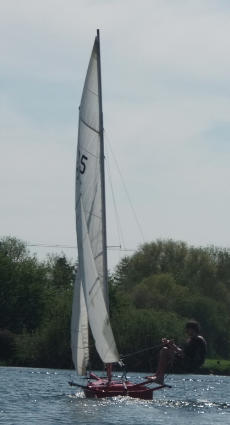

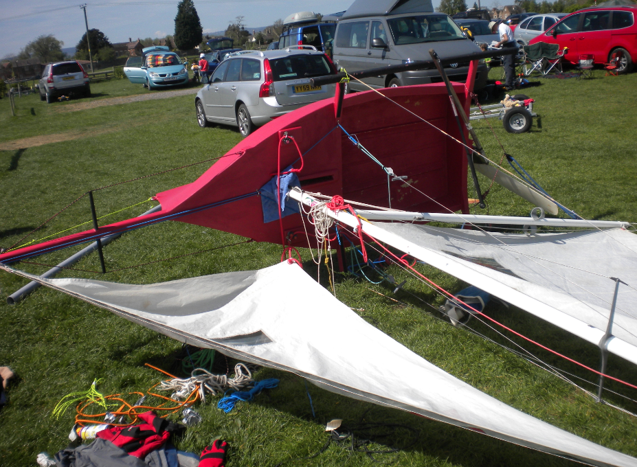

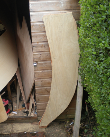

A friend and I decided a while back to build a tiny boat to put the laser 2 rig on. We have finally completed this crackpot idea. It is just over 7ft(same as an oppy), has a 3.5ft bowsprit, and the boom overhangs the stern by about 3 ft. While it does sail, we are experiencing problems with huge amounts of weather helm due to the sharp bow digging in, and having the rudder much further forward than the laser2. We have raked the mast as far forwards as is reasonable but are still having trouble, are there any other ways to move the centre of effort forwards a bit without moving the whole rig?

My first thought is, can you move the CLR aft? A rudder gantry?
A longer bowsprit?

Your centre of effort from the sails is clearly too far aft relative to the lateral resistance of the hull. Something has to change. Putting the rudder on a gantry will reduce tiller loads and help a bit, but it won't solve the root of the problem.
Could you move the rig forward, and increase the bowsprit length and/or move the centre/dagger board aft.  Or make the boat bigger (or even the jib) Wink

Thanks, I have some spare ply that I could make a new daggerboard that is angled back to move the CLR if that would help. The rudder gantry sounds like a fairly simple job compared to the major surgery that would be required for a new bowsprit so I think I will try that first. Thanks

Its definitely very good for honing your balance and trim skills, also it makes you realise the forces the rig actually exerts, that all other boats are stable enough for you not to feel. And if you want to improve your swimming then this is definitely the boat for youWink

Before you go for major surgery - is your rudder as balanced as it could be?  All too often I hear people talking about weather helm , when what they have is a boat that isn'y being sailed flat and a rudder with a bit of aft rake in it.
Date Posted: 06 May 13 at 11:26pm
The thing about weather helm and all that is that most of the older books at least are completely wrong about it, because they take the view that the boat should just use the centreboard as CLR, and the rudder should be neutral. Not so. A decent setup on a dinghy balances the sideload between the two foils.
Your daggerboard looks a good way forward to me, but its not outside the range I've seen work, but the big thing of course is that the rudder is also a long way forward. I concur with Rupert that a rudder gantry will be a good thing and absolutely the first thing to try, but not only for balance, but also because you'll be able to have much more room in the boat and it will have much better ergonomics, which in itself will help.
But also I think a big thing is that you have a very wedge shaped short little boat there, and I reckon she will hull steer like crazy when not absolutely bolt upright... I find it hard to believe in the bow digging in very much per se and affecting weather helm, but I do believe the hull is going to steer the boat a lot and there's nothing you can do about that...
So yeah, get as long a rudder gantry as you can on there. If you can get the two foils in the same position relative to the rig they are in the Laser 2 that will be a pretty good place to start. Also with the foils farther apart everything will be a lot less critical, most notably the steering.

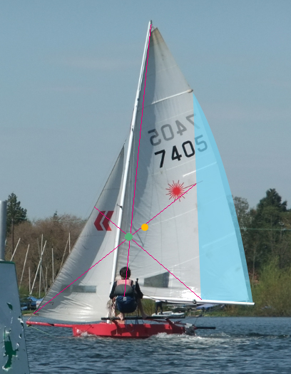

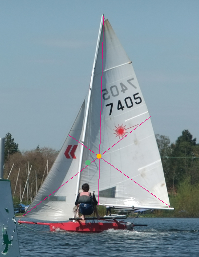

Thanks for the diagrams anyway, it gives me an idea of how far the CLR and CofE need to move.
Fortunately its not too critical. As long as the CLR is somewhere between the two foils it won't make that much difference... Ideally the rudder would be as far back as an LII one, but I reckon if you make the gantry the same length as the tiller it won't be too far out. Fortunately you have the wings as a point to get a really good angle for the sideways loads...

Posted By: Reuben T
Date Posted: 11 May 13 at 11:49am
The new dagerboard I'm making to try to move the CLR back a bit, yes my shed does need a bit of a clear out.Embarrassed
