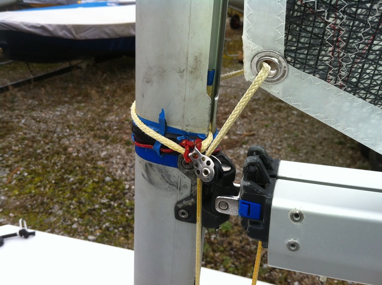

NIckA / NickM / Mr Holman... on the basis that I'm one of the guys who one less bit of string is a good thing, where should the cringle get tied to when fixing?  There's a split pin fitting on the boom, I don't have a split pin for it, but tie it to that,  but am I better to use some thin dyneema and tie it dead tight against the mast instead?

Nothing illegal about that in a Solo, fix the tack however you want.
I have the adjustable in haul on my Boon Solo, and very useful it is too, I do adjust it regularly throughout a race, usually off downwind, bar tight when I'm overpowered upwind and slack take out of it at other times upwind. On the other hand like pondmonkey you could just tie it off.

Hi Roger,
Thanks for the feedback- if possible, could you take a snap of the inhaul system, how it's rigged etc and post on here when you get a mo?

No problem Jimbo, its not easy to describe anyway so a picture makes sense.

OK, picture below.
A small block is attached to the mast just above boom level, it's tied as tight as possible and then the ropes are taped over as you can see in the pic, tape is getting a little worn and needs replacing really. (There are about 4 loops of very thin line around the mast, thus giving lots of friction)
Line comes up, through the small turning block, through tack of sail, round mast and I then slot it through the back of the small block, tie a thumb knot in the end of the rope and drop the knot into the track on the mast, this secures the end. The line is obviously going down to a block which then twins the control to both side decks.

Thanks Roger- definitely think it would be useful downwind
