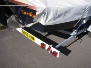

Whist the practical issue of towing and how to tow is important, I think that there are more important issues to be discussed relating to the new EU trailer regulations.
Consider the financial implications of this:
There is discussion relating to lighting whereby all electrics have to be WITHIN the trailer.
In addition, there would be no overhang permitted, and side lighting may be required.
This means that the trailers might look like this. The implementation date seems to be 2016 and 'a week is a long time in Europe', but are we ready for this?
http://flyingfifteen.wordpress.com/2012/10/16/maybe-the-future-of-trailers-looks-like-this/ - http://flyingfifteen.wordpress.com/2012/10/16/maybe-the-future-of-trailers-looks-like-this/

Someone will have to define 'within the trailer'. Ribs & powerboats are generally launched off their trailers - not separate trollies like us dinghy types habitually use. It is a requirement for them to be able to remove the electrical components entirely, before they're completely ruined by immersion.

have just got a new double trailer from sovereign trailers ( great bit of kit .) and talked to the guy in charge a lot about it. he was generally in favour of it, because he felt it would raise the quality of trailer manufacture, even if it would cause him some problems.
the only visual differance is that lighting boards have to be attached to the trailer, not the boats and lights on the mud guards.
it just means before loading or unloading you would have to undo a couple of bolts to remove the lighting board assembly.
at least it would mean it is less likely to fall off, when on the move!LOL

Posted By: Telltale
Date Posted: 07 Dec 12 at 3:02pm
The way it works is the lighting board arms slide in and out within the trailer base and so is removable, you just pull it out, then you can launch. Anyway with an LED trailer board it probably wouldn't matter anyway being "impervious to weather".
Date Posted: 07 Dec 12 at 3:12pm
hmm, I suspect "impervious to weather" != "salt water immersion proof"

Looking at the trailers at the dinghy show with fixed lighting boards, I cannot see how these meet the rule about having lights at the rearmost part of the rig when a boat is on and overhanging at the back. Surely you'd still have to have a separate lighting board on the boat to ensure that some Audi driver doesn't try to hoopla his rings on your rudder pintles.
Posted By: Do Different
Date Posted: 09 Mar 13 at 2:35pm
Re Trailers at Show. Speaking from a point of ignorance because I wasn't there, but, were they not telescopic and retracted for the purpose of space saving at the Show?
Posted By: RS400atC
Date Posted: 09 Mar 13 at 2:56pm
That's what we do with trailers on bigger boats, RIBs etc.
I would think with a bit of thought, there are sensible solutions.
Rather than just fitting a bracket for the current sort of trailer board.
I don't think my trailer board would be very reliable if kept outside in a salt environment all year round.
As a new Sovereign combi is now a grand, it seems worthwhile to go for single vehicle approval if necessary.
It's just another half-baked bit of bureaucracy.
Posted By: Paramedic
Date Posted: 10 Mar 13 at 7:20am
with a boat on the trailer whats wrong with hanging the board on the boat as we've all done for decades? If the board works noones going to stop you because your trailer is too new.
When there isnt a boat on the trailer use the brackets. Simple :)
