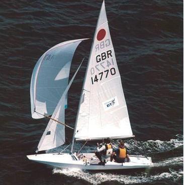

Stu mate - if we are gona build this I reckon on a furler jib like THIS!!   But also longer wheelie bars are needed!
