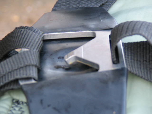

I just bought a new harness with the RWO quick release hook, and was a bit disappointed to find that the hook decided to come out whilst I was on the wire, leaving me in the water!  Fortunately I had a spare but I don't want this to happen again, and am contemplating just abandoning the quick release system for a normal hook.
I was wondering who else had had (or knew someone who has had) an experience with a quick release hook failing on them like this or if it was just a fluke.

However, I have twice been out in a boat with someone who does. Both(!) those times the qr hook has failed on them (different people & different harness).
Maybe it's some very bad luck but I'm very dubious of something that, in my experience has a 100% failure rate :)

Happened to a couple of people at Wilsonian too.
If you don't have a spare hook then you're stuffed, especially in the likes of an MPS/RS700 - could even be dangerous.
Better off with John Waddington's flush hook:
You don't get tangled up using this in the first place - or puncture your nice epoxy-sandwich hull climbing back in...

QR hooks are absolutly rubbish, the RWO version is the best out of them but it is still crap. The problem with them is that they just seem to release the hook for no reason or if the hook stays in the its normally really hard to actually get it to release. I have one harness with and one without, but I do not find it a problem because i never take my hook out so i imagine that it would not come out if i needed it to anyway. It would take me less than a minute to take my harness off but i suppose when something happens on the water and you think that your hook might be stuck you just need to get you harness off straight away but thats probably not what you are thinking of at the time.

The hook is made of stainless steel, and apparently needs to be that thick, as a lardy boy bent a thinner one.
There are various versions available besides the spreader bar, including one for the Banks skiff harness. Banks are or were at one time offering them as original equipment (albeit unadvertised - the market is so small).
I 'encouraged' my crews to adopt it mainly to preserve the boat's topsides having suffered from damage from a conventional hook on my Winder Fireball, but the non-tangling aspect is a serious benefit - I nearly copped it myself once while righting an old FD (the hook locked onto the gunwale lip so that the boat came over on top of me while I was still stuck there, pinning me under water). Another time, my crew's conventional hook got hooked on the underwater shroud in a capsize... scary.
I'm not at all convinced by the releasable hooks. Besides wrecking your topsides, I've also heard they can be tricky to release under load.

my magic marine quick realise hook has caused so much problems in the past 2 months
It almost came undone whilst going round texel without me pulling the string (not impressed)
So I cut the string to stop this happening again
At the next event I checked my hook as I always do before going out to notice the hook had partially come undone again -  NOT GOOD
I am changing back to a non quick realise hook for safety!

I have had exactly the same trouble as "hurricane" with the Magic Quick Release thing. I have looked down at my hook on two occasions to find the hook going off to one side, meaning that the release pin is half out.
I changed back to the normal type and sent the QR back to Magic, asking for a refund. They sent me a whole new QR spreader bar, saying they had refined the product- admittedly great customer service. It does seem more secure than the first one and I am giving it another chance.
These QR things also stick out a lot further than the normal ones, increasing the risk of a tangle in the first place.

I've had two RWO QRH hooks.  I used to test it every few weeks stood on the shore and the first one stopped releasing unless I leant over to the left.  That's not "got a bit tricky to relase", that is a "would not budge now matter how hard you pulled".  Apparently it was "a one in a million weld failure".  When my new hook then became number two in a million I gave up and went back to a conventional hook...

I've heard of many more accidental quick releases than people saved from entrapment.
Risk = probability x severity .... doubt a QR hook reduces risk overall.
We now have one of those flush hook jobbies, a little harder to hook into but it releases surprisingly easily on a capsize and there there is virtually nothing it can snag on.  Plus saves my nice new gelcoat.
Still, I should think a QR hook is a more realistic way of getting free if the worst did happen, than carrying a knife.

I have a Magic marine quick release harness but a quick test on the beach showed neither this nor the Crewsaver equivalent my mate was wearing actually release whilst under tension.  I therefore have no confidence that they add to my safety but whilst there is a chance it might work, I'll still wear it.  Why not?  I just make a habit of check the release pin is fully engaged before each sail and it has never accidentally released.  I also carry a spare hook in case I do have to use it in anger.
