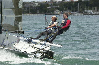

photo taken from http://s10.invisionfree.com/12ft_skiffs/index.php?showtopic=107 - Here

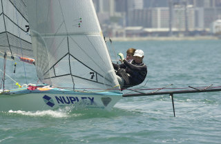

Racks... Nothing ive seen stops 12s running racked wings but their current designs just dont suit them
Difference between false floor and gunwhale height: could present issues... some of the racked boats have pretty low gunwhales, but then for this purpose could you argue the rack represents the gunwhale?
The way around this would be solid "wings"
Originally posted by Isis
T-foils are allowed in cherubs, and not in 12s...but this is pretty painless to swap between
T-foils are NOT allowed. It has been kicked around a bit, however its thought it would obselete the whole fleet overnight like the I14

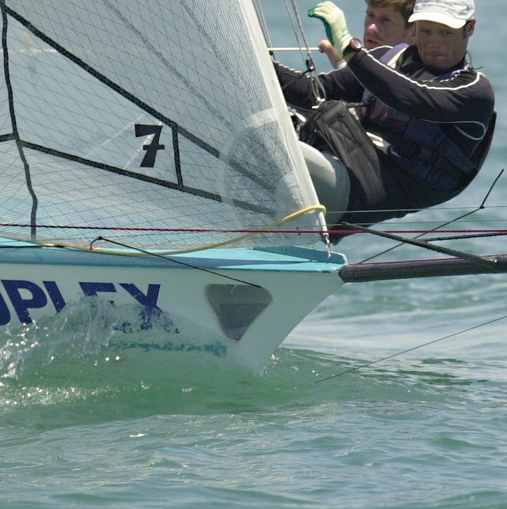

Snout shape... there might be something banning bouyant snouts in 12s? not sure....
Bouyant bows, mmm
Ginge won the Inters with this, note the cut outs which are covered from the inside with plastic
Up close
