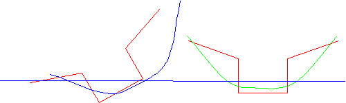

Date Posted: 24 Jan 06 at 1:41pm
Seems folk aren't interested in posting the numbers, never mind save me some work.
The factors I would look at for "roll tackiness" would probably include waterplane area distribution (ie whether the boat is fatter in the middle than at the transom) rise of floor both in the midle and at the transom, how vertical the topsides are, rocker amount and distribution and so on.
for instance if you compare a Merlin with a modern Cherub, both are equally flat floored in the centre but the Merlin has more rocker, much less vertical topsides - thus more buoyancy further out when the boat is heeled, more rise of floor further out and the waterplane much more towards the middle of the boat. Some of those differences will be related to what's different in "roll tackiness" between them, some not...
Here's a very crude and stylised representtion of how differently the two sorts of shape float when heeled.
