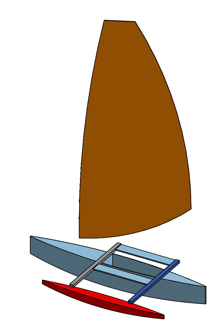

Remembered call, called a Quill
https://proafile.com/multihull-boats/article/quill-a-crab-claw-tacking-proa" rel="nofollow - https://proafile.com/multihull-boats/article/quill-a-crab-claw-tacking-proa
Having built 3 Proas I think a tacking proa has a lot of mileage. Bolger-esk dirty sketch, I doubt they would let me race it though.

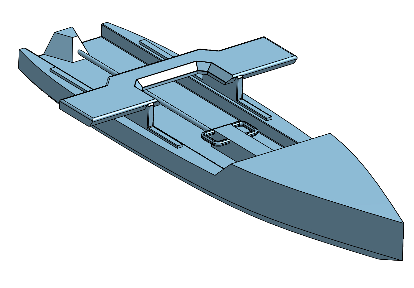

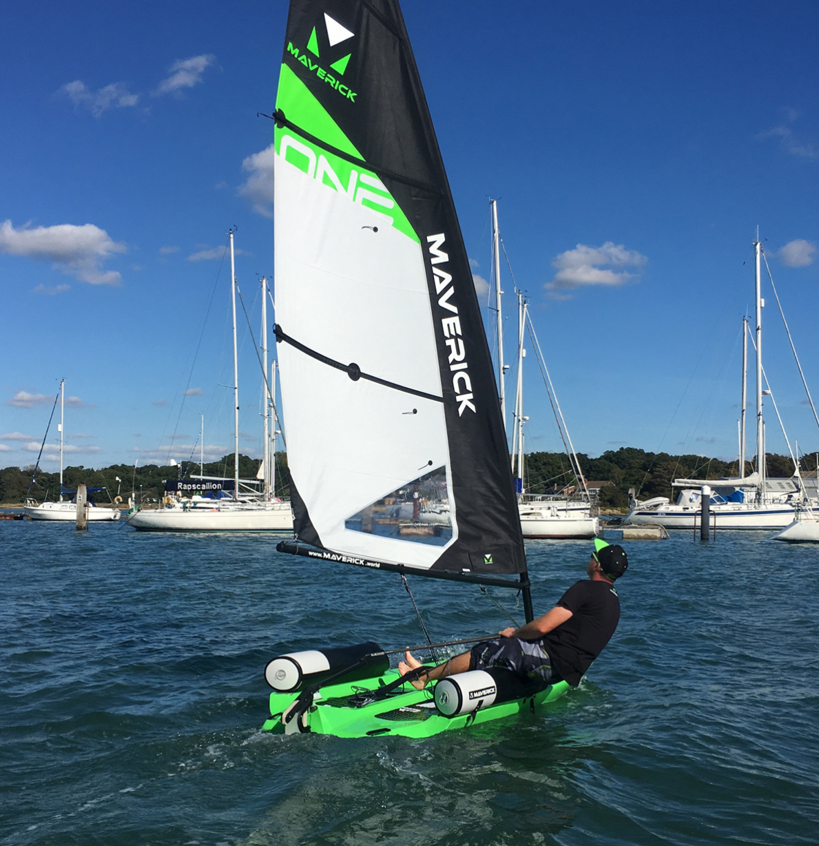

Nice ideas, I have frequently thought local  ‘benches’ a bit like the Maverick would make the Laser more comfortable while keeping the low free board and ease of righting

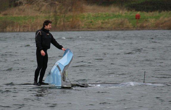

From this angle I think the 80%er might need to be doing a lot of yoga to recover efficiently from this. The Blaze has the option stepping onto the gunwale forward of the rack to recover. Clearly this is only one aspect of the design. Many Blaze sailors appear to spend a lot of  time kneeling in the light stuff, which Streaker, Solo and even Laser sailors don’t need to worry about.
Tink
https://tinkboats.com
http://proasail.blogspot.com
Date Posted: 21 Dec 19 at 8:20pm
If assuming a boat will capsize,that photo looks better than most. The central buoyancy doing its job well.
Agree with that, a 37 plus inch inside leg is tall order mind
Tink
Date Posted: 21 Dec 19 at 8:36pm
Hmmm, 11" out. Might have to jump, or stick with a 4' wide Minisail!
Posted By: tink
Date Posted: 21 Dec 19 at 9:10pm
Minisail is a good call, maybe with
  • a higher seat carriage - for ergonomics,
  • thicker seat with buoyancy like IC
  • updated carbon rig
Tink

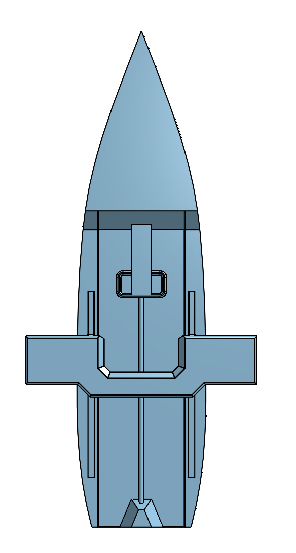

Posted By: tink
Date Posted: 22 Dec 19 at 7:57am
Ignore the hull shape, using free CAD package which allows me to think in 3D
The idea:
  • Low freeboard for easy re-entry
  • Buoyant seat, fixed athwart-ships but slides fore and aft. Allows for comfy sitting on all points of sailing and wind conditions. Rather than straddling seat would sit with both legs forward, hence cutout.
  • Relatively narrow hull not requiring large sail area
Just a morning coffee doodle,
(Sorry about font size, don’t know why it sometimes does this)
Tink
Date Posted: 22 Dec 19 at 8:08am
Looks a little bit Laser eps, but with less of a toilet seat!
Posted By: tink
Date Posted: 22 Dec 19 at 8:56am
The idea is not have a toilet seat, wings, excessive beam etc in the way when you climb in off the board plus a traditional thwart all able to move fore and aft.
Tink
Posted By: 423zero
Date Posted: 22 Dec 19 at 10:07am
The Sprint is a doddle to get in, you can actually sink the back half of boat, you can almost swim onto boat.
Would be easy to fit buoyancy under seats.
Robert
Posted By: Sam.Spoons
Date Posted: 22 Dec 19 at 10:10am
I'm a short4rse and have no difficulty climbing from the board over the side when righting the Spice which s only 5cm narrower than the H2. I have had a lot of practice though Embarrassed
Posted By: GarethT
Date Posted: 22 Dec 19 at 10:36am
The easiest boat to right and get back on board that I've ever sailed is the Europe. Can pull it upright with one hand and pretty much float back in.
Just need to be flexible enough to get under the boom tacking!
Date Posted: 22 Dec 19 at 11:10am
I had to give up sailing my Europe like Int Moth because it was too easy to right. I couldn't climb on an inverted hull because nothing grippable was within reach. I couldn't climb on the board because the boat righted itself before I got on it, and I couldn't get back in with the boat upright because the weight of the rig capsized the boat on top of me. The solution would have been to lose a few pounds, but somehow I couldn't manage that either...
Date Posted: 22 Dec 19 at 11:20am
Tink's concept.
The challenge will be fore and aft trim. Sliding seat back and forward is a pain in the neck. People have produced systems that slide under load, but horribly expensive (think four high load ball bearing mainsheet traveller cars as the foundation). With an IC the canoe stern tends to mean it squats at speed, which reduces the need for fore and aft trim. You could get the same effect with aft rocker, but its a horrible destroyer of speed.
It might be worth considering folding winglets which flopped into the boat when on her side. If my PlusPlus were still about it might be possible to do an experiment, but the winglets would need to be narrow enough that you could get in the boat between them, and mine nearly met in the middle.
Posted By: tink
Date Posted: 22 Dec 19 at 3:46pm
Tink's concept.
The challenge will be fore and aft trim. Sliding seat back and forward is a pain in the neck. People have produced systems that slide under load, but horribly expensive (think four high load ball bearing mainsheet traveller cars as the foundation). With an IC the canoe stern tends to mean it squats at speed, which reduces the need for fore and aft trim. You could get the same affect with aft rocker, but its a horrible destroyer of speed.
I never found moving the seat on my IC much of a chore. It didn’t move under load but was easy to stand up on the gunwale, feed wide apart and pull a rope. That moved it backwards and the main sheet pulled it forward. The track was just jib track with solid Delrin sliders
A mate has a Toy and like Minisail the carriage is fixed. He says this isn’t an issue so perhaps a scow hull would be better and use a fixed seat.
I was thinking of folding wings on the drive to the cub today, was trying to figure out how to stop them folding in violently.
The thwart is the big one for me, watching guys kneeling halfway around the course today, not something for an 80%er
