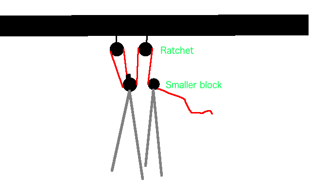

Have you got any closer pics of that arrangement or could post up a schematic? My arrangement has just ripped the top of the turret off my Solution set up so I need to get something sorted for the weekend, I doubt a new turret will arrive in time and that looks interesting.
Date Posted: 04 Jan 17 at 3:01pm
My guess is better alignment of the blocks, so less friction.

Date Posted: 04 Jan 17 at 3:59pm

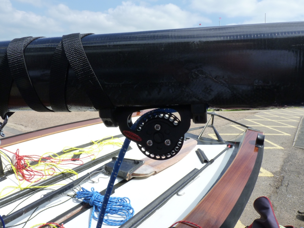

I'll second off the boom sheeting with a rear bridle on the Blaze, I was skeptical before I tried it but it is way better on several counts (much lighter sheet loads and the clear cockpit being the main two). I might move the ratchet block to a point opposite my upwind position as It's hard to use two hands with it off the kicker attachment.
The 'nova arrangement is quite different though, a centre mainsheet with the last turning block at around deck hight instead of on the floor/turret. The only reason I can think of is to get the mainsheet lower than off the boom. The extra wrap idea makes sense but as most ratchet blocks work fine with the sheet in contact for only around ¼ of the circumference I'm not convinced that is the reason.

On my Farr I use a rear bridle, run the mainsheet along inside the boom to a Ronstan pivoting ratchet block. This results in a completely clear cockpit and a nice direct angle for off boom sheeting. Works great from the trapeze. I use 1:1 when it's lighter and pass through a turning block on the bridle (shown) for 2:1 when the breeze is on.

A belated thanks Glitcher7 for posting that schematic, if I can't fix a temporary solution to my broken turret I shall give that a try.

Yes Mossy, no problem with sheeting angles. This is an oval section carbon boom which is really oversize for the boat but allowed the pivot block to be recessed up into the boom so the sheet can run inside and prevent hanging incidents.
With a gantry at the transom I can just get a long enough trapezing tiller extension to be passed thru forward laser style.
The wrap is enough for the ratchet. I thought it would take more work to develop trapeze helming techniques without a cleat, but it hasn't been too bad.
I'm sure I need to do more to tweak bridle lengths and kicker tensions, but without other Farr's for boat on boat comparison it's tough to work out

Originally posted by PeterV
There's a lot of misunderstanding of purchases on here! The ratio is counted at the moving part, which on a mainsheet is the boom. If the sheet starts here, goes to a block fixed to the boat and back around a single block on the boom the ratio is 3:1 (Laser arrangement).
Erm... except that's not what the ratio refers to. The ratio is a movement ratio (velocity). I.e you pull 2m, it moves 1m. You still have to put the same energy in (by pulling more rope), but the loads are reduced.
People often work out the ratio by adding up the lines coming out of the moving end... but that only works when you have one fixed point and one moving point, and you're working the rope from the fixed end...
So the laser main does not pull at a 3:1 purchase... It pulls at 2.X:1 because the boom is rotating about the mast, meaning the 'third' purchase off the boom doesn't move as much as the block on the boom end for each degree. If the block was half way along the boom, the maximum ratio the system could achieve would be 2.5:1. But that depends on the angle you're pulling from and whether that block on the boom is actually getting any closer to you as you pull.
For instance, the crew on a 29er, standing at the mast pulling on the main sheet. As they pull, the block mid way on boom doesn't get any closer to them, so it's adding no effective purchase, and he's got a 2:1 system. Or... if the crew was on the leeward side of the boat, sheeting in, it would even be less than 2:1!
It's complicated still further in that booms don't just rotate in one direction (in and out), but up and down too.

P.S. if you want clear space to move freely under the boom, but don't want the issues of sheeting directly from the boom (moving part, still got a sheet floating mid air which can catch on crew), then you can have aft sheeting, run the sheeting inside the boom, down the mast, under the deck and coming up out of the floor. I've seen that on some yachts.
edit: "Admiral's Cup 2:1"   http://www.harken.co.uk/content.aspx?id=3901" rel="nofollow - http://www.harken.co.uk/content.aspx?id=3901
Posted By: PeterV
Date Posted: 06 Jan 17 at 3:06pm
Sorry Mozzy, your calculation of 2.5:1 is wrong, and your example of the yacht arrangement demonstrates why, as you can arrange any number of blocks to change direction, including taking the sheet to the mast and back but it doesn't change the purchase at the end of the boom which is where the power is applied. It's very simple to demonstrate as the ratio (strictly the velocity ratio) is the amount of sheet pulled vs the amount the moving part moves. This is not affected by where the end of the sheet is arranged.
You can add any number of block and they don't add purchase as long as those blocks don't move in relation to each other as the boom moves. In the linked diagram as you sheet in, block C at the goose-neck doesn't move in relation to A on the boom or D on the floor. It is therefore a fixed block and adds no purchase.. so the system stays 2:1, despite all the extra blocks.
When the rope comes off the boom at the mid point, that is a moving block (it get closer to the deck block as you sheet in). It's just that block in the middle of boom doesn't move as much the ones at the end, so has less impact on the velocity ratio. And like I said if you're taking the rope directly from midway on the boom, as you move around the ratio will change.
