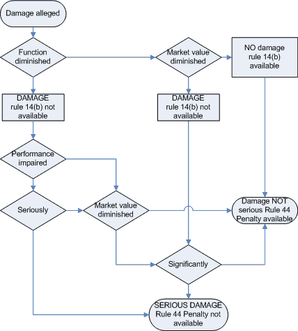

Combining different texts I have come up with the following proposed guidelines.
I would appreciate your opinion:
Serious damage is any damage that seriously impairs the performance of a boat or her crew, or seriously diminishes the market value of the boat. Serious damage has occurred when the normal operation of the boat is compromised, and its structural integrity may be impaired. A prudent owner will repair serious damage promptly even though the boat may be able to continue to race, with or without temporary repairs. Repairs will generally require more than 3 hours work.
Gordon
Posted By: Brass
Date Posted: 05 Mar 14 at 11:50am
Try the marked changes.
Serious damage is any damage that seriously impairs the performance of a boat or her crew, or seriouslysignificantly diminishes the market value of the boat.
Serious damage has occurred when:
  • the normal operation of the boat ishas been compromised,
  • its structural integrity may have been impaired, and or
  • its hull integrity has been significantly breached.
Serious damage is damage that aA prudent owner will repair promptly even though the boat may be able to continue to race, with or without temporary repairs. Repairs will generally require more than 3 hours work.
So we have produced an elegant little paragraph.

Posted By: gordon
Date Posted: 06 Mar 14 at 10:15am
The problem is that different protest committees (and even international juries) seem to have  widely different opinion on what constitutes serious damage. Some seem to think that damage costing several grand to repair is not serious if the boat can finish the race! Others, my self included, hold that a hole in a boat is serious damage Coming back to port with a hole in your boat should not be a normal part of sailing.
Gordon

Posted By: Brass
Date Posted: 07 Mar 14 at 1:30am
Does this flowchart, based solely on JM section M help?

As I have indicated, my opinion is that we are best served by sticking within the parameters of JM Section M, namely diminution of market value and diminution of functionality and performance.
Critically, the reliance on market value implies that seriousness of money costs should be considered proportionately to the value of the boats concerned.

I think the Judges Manual M3 moves us beyond the ordinary english usage.
We seem to be agreed that, in accordance with Judges Manual M3, damage is 'serious damage' if the performance of the boat ... was seriously impaired.
How can a boat suffer physical damage which makes her score significantly worse without her performance being 'seriously impaired' (and thus the damage being 'serious damage')?
It seems to me that the way to go for the protest committee in these circumstances is, either on receipt of the written request for redress, or at the beginning of the hearing, unless it appears that the requesting boat is not entitled to redress, to consider the requesting boat's description of the damage and its effects, (if necessary inspecting the boat) and decide whether the protest committee considers the damage to be serious damage.
The protest committee could then consider whether it was possible or likely that the requesting boat may have broken rule 14 or another rule or Part 2.
Once the protest committee forms an opinion that the incident may have involved serious damage, the protest committee can protest the other boat under rule 60.3(1).

The Judges Manual, Section M discusses damage as follows
M.3 Serious Damage
This is not possible to define but a protest committee should ask:
• was the performance of the boat or crew seriously impaired?
• was the market value of the boat significantly diminished?
• was a crew member seriously injured?
Are you saying that you do not agree that, in accordance with this guidance, damage that seriously impairs the performance of the boat is serious damage?

Similarities to straight damage as discussed in Case 19
Question
Is there a special meaning of ‘damage’ in the racing rules?
Answer
No. It is not possible to define ‘damage’ comprehensively, but one current English dictionary says ‘harm . . . impairing the value or usefulness of something.’
This definition suggests questions to consider. Examples are:
• Was the current market value of any part of the boat, or of the boat as a whole, diminished?
• Was any item of the boat or her equipment made less functional?
Date Posted: 19 Mar 14 at 11:26am

Case 19 is about what is and is not 'damage', which is important for rule 14( b ).
'Serious damage' is important for rules 44.1( b ), and 60.3( a )(1).
Gordon proposed a list of types of serious damage.  I think this is an approach that the drafters of the Cases and the Judges Manual are carefully avoiding.

Case 19 does not address serious damage at all: it's all about the bottom threshold.
Looking at Case 19, what I think it is trying to do is to set a lower threshold, below which scratches and chips and so on should NOT be considered to be damage (essentially for purposes of rule 14( b )).  Hence Case 19 introduces the criteria of diminution of market value and diminution of function.
What Case 19 is pointing towards, without quite saying it, is that if there is no diminution in value and no diminution in function or performance, then there is no damage.  I have no difficulty with this.
I don't think Case 19 rules out damage that needs to be repaired.
What it does do, is rule out extravagant claims that a scratch that really would buff out requires massive repair work.

The MR guidelines are also limited as follows:
  • they are valid for boats usually used for match-racing, size say from 6m to 15m, hardy construction, not pristine, high finish beauties;
  • they provide an extra additional penalty over and above those normally applicable;
  • they are designed primarily to protect the OA's boats, not really to provide a carefully calculated 'proportionate' additional penalty;
  • they are a bit like a call, a bit arbitrary, put there to assist the Umpires rule 14 panel to make a quick decision on the water and avoid a lengthy philosophical protest hearing.
Posted By: Presuming Ed
Date Posted: 21 Mar 14 at 12:52am
That is like saying the offside rule is different at Manchester United because they have different values there!
Isn't it?
Posted By: Brass
Date Posted: 21 Mar 14 at 1:14am
Isn't it?
Just like sailing.
The rule isn't different.
The way it's applied in the Premier League is a bit different from a Saturday afternoon mud heap.
