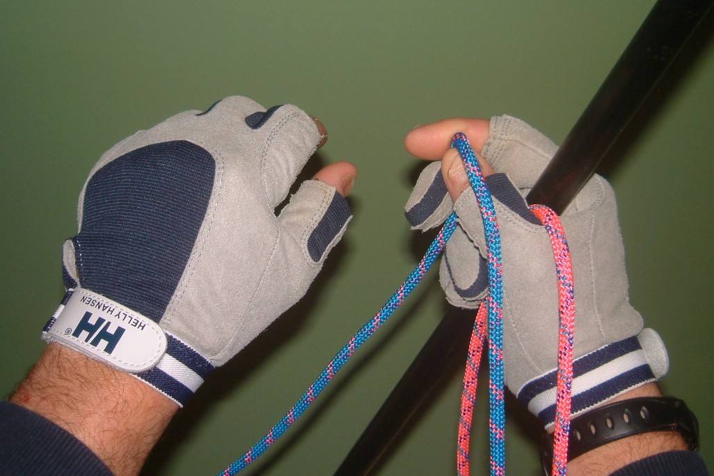

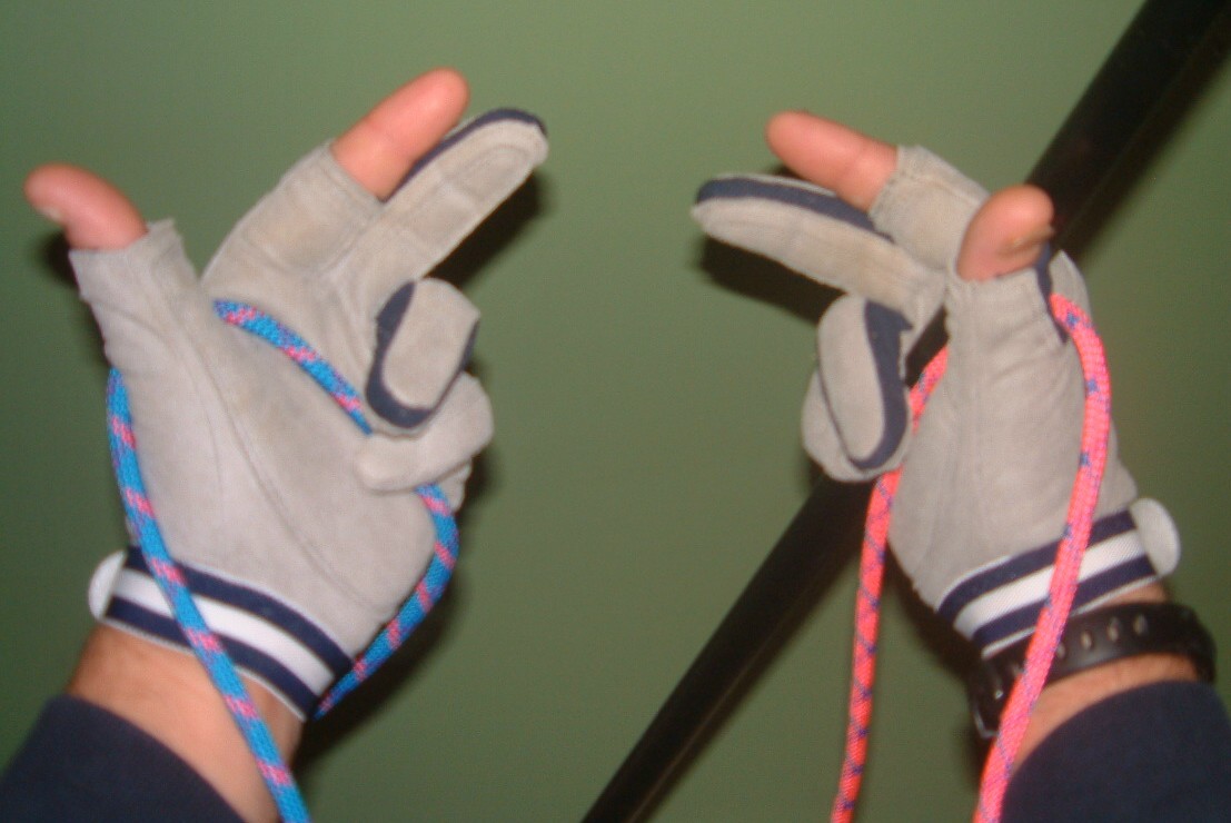

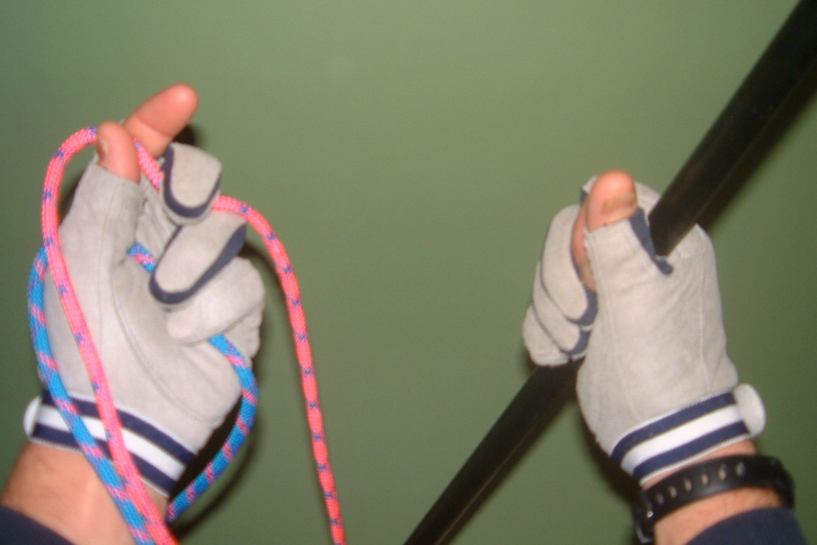

Posted By: sten
Date Posted: 14 Oct 05 at 8:41am
Posted By: sten
Date Posted: 14 Oct 05 at 8:42am
Posted By: sten
Date Posted: 14 Oct 05 at 8:44am
Posted By: sten
Date Posted: 14 Oct 05 at 8:52am
Hope pics make it easier to understand
Note sure how you do the jibe unless its a self tacker. Bite it? (not recomended for peolpe with false teeth) I guess it will flap a bit
Have fun learning
Posted By: billpayer
Date Posted: 14 Oct 05 at 8:58am
Thanks for pictures, that is sort of what I do, but nice to see someone else suggesting the same approach. I think I'll try the cleat main, but hang on to the sheet with back hand option. Locically it seems best. As for the jibes, yes the teeth are used if the wind is light, but a slow steady fairly deep gibe, kite and main across, then jib, then head back up again, I certainly will not be winning any races with the current speed of my single handed jibes, but its getting there.
