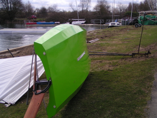

I'd sold it before that came out but why? 7.4 is pathetic, how is it I can compete with a 9.5 holding it in my bare hands, an 8.5 is a change down sail, why should I have to have a 7.4 that girls and small children use to windsurf race with?
Why, somebody tell me why that is, sensibly now it's an honest question, why can someone my weight happily cope with an 8.5 on a sailboard but not on a dinghy? If the answer isn't that they are better designed and more fit for purpose? Edited by iGRF - 05 Apr 13 at 4:25pm |

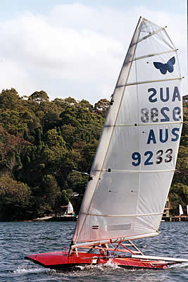

because it's more efficient? 8M is the max allowed on a Moth...

But the key to reducing wetted area is to reduce the waterline beam, then the boat becomes too tippy (vide Moth). The fatties don't have this problem - they can have a good sail area/wetted area ratio for light airs merely by being able to 'support' a load more sail area. You can, as a lightweight, increase the sail area by using sitting out aids à la IC, but then again you are into handling problems.
The answer would be a 15 foot version of the tunnel hull scow Moth, and that was the tragedy of watching your V2 folly unfold. If you'd only stretched one of these up to a decent waterline length, kept the weight minimal and put a Halo rig on it, you'd have had a viable, easy s'hander with a PY of maybe 920, even without the kite: |

Well I was after an offshore fast planing thing and didn't appreciate just how heavy it would end up, and the planned waterline on the Original spec was the same as a Contender, things just didn't work out exactly as they should have, but then the chances of getting it right first time....
If I can find someone a little closer to home that i can oversee what they're up to, I won't get it wrong next time. |
