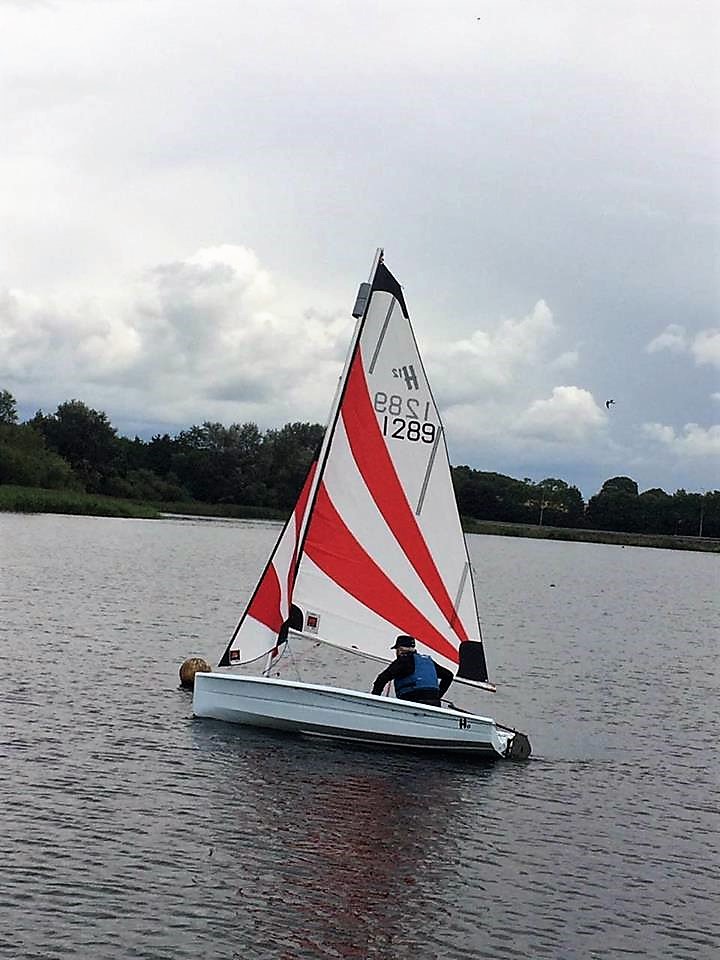

I am 72 and after sailing offshore for over 28 years decided to get into dingy sailing with my son and granddaughter.
I looked at various models including the ones you mention but finally bought a Hartley 12 which I mainly use single handed, but they are classed for 3 but can easily take two crew, a good user friendly and stable boat and a lot faster than you might think,I would recommend one including the head sail version.You can also reef them very quickly and also has center board. |

I'd forgotten about the Hartley 12. Though I haven't seen one a couple of people on here have said they are a good boat. I'm not sure if you'll find a used one though.......

Thanks. I hadn't come across the Hartley. It certainly seems worth a look although, as you say, there may not be many around second hand.
