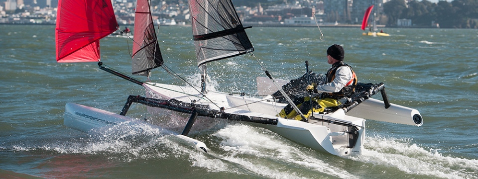

Weta
edit: pic added

The lake is fairly small so as much as the weta does appeal I don't think it's going to fit the bill.:(
